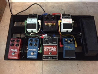

I am new to the board so I apologize if this has already been discussed, but I couldn't find it during a search. Yesterday, I installed my VL Power 2 Plus onto the underside of my Pedal Train II using the VL brackets. Everything works as it should, but when I flip it over (right side up), it seems as though the Power 2 Plus touches the ground a wee bit so the board is no longer flat on all 4 corners. This seems to be a bigger problem when using the wah pedal. Has anyone run into this? The power adapter holes are lined up perfectly and the Power 2 Plus snapped right into place as it should. It's almost too tight because I don't think I can get it out unless I unscrew one of the brackets. Thoughts? Thanks.
Attached pic of my board just for fun...not the underside, but I can attach one if needed.
