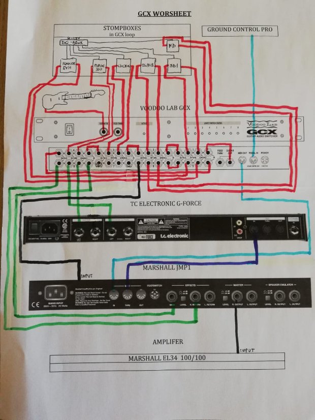

Hello! I'm creating my new rack and I'm currently preparing and soldering the connectors ... Is it correct how I am going to connect them ?? (please, check out my drawing on attachment) Thank you all. I gladly accept your advice ..

Hi there,
It will be a nice setup man, it will work fine.
You can set it up as you have, with the G Force in the fx loop of the JMP-1 and a loop in the GCX or you can place it in between the JMP-1 and the EL34 100/100. If you do this, you make a preset in the G Force with no fx blocks activated and choose this in the preset in the GC Pro to have them off. You can set an Instant Access button to turn an fx block on in the G Force. Also, you will be able to turn the volume of you rig up and down with the input/output of the G Force. If you do it this way, you set the G Force to kill dry mode.
It’s up to you how you set it up, I prefer the way I’ve said, between the pre and power amps. At least this gives you an idea of what you can do. Good luck

Thank you man!! And thanks again for share your idea. It' s really not bad and I have to try it. It also could sound better between them! Thank you!
