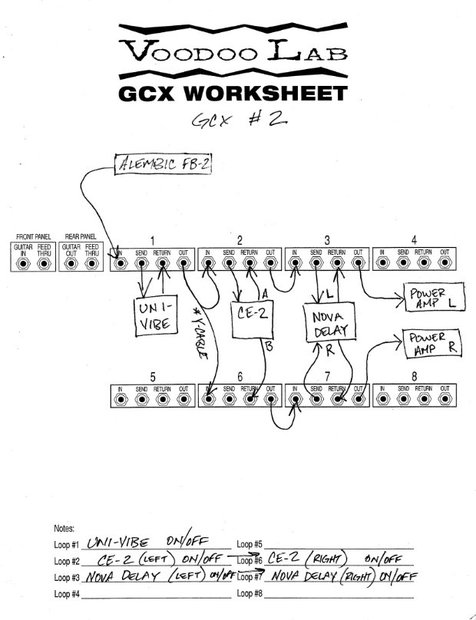

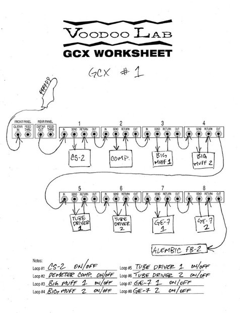

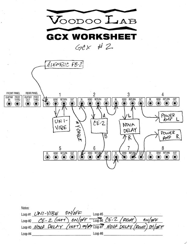

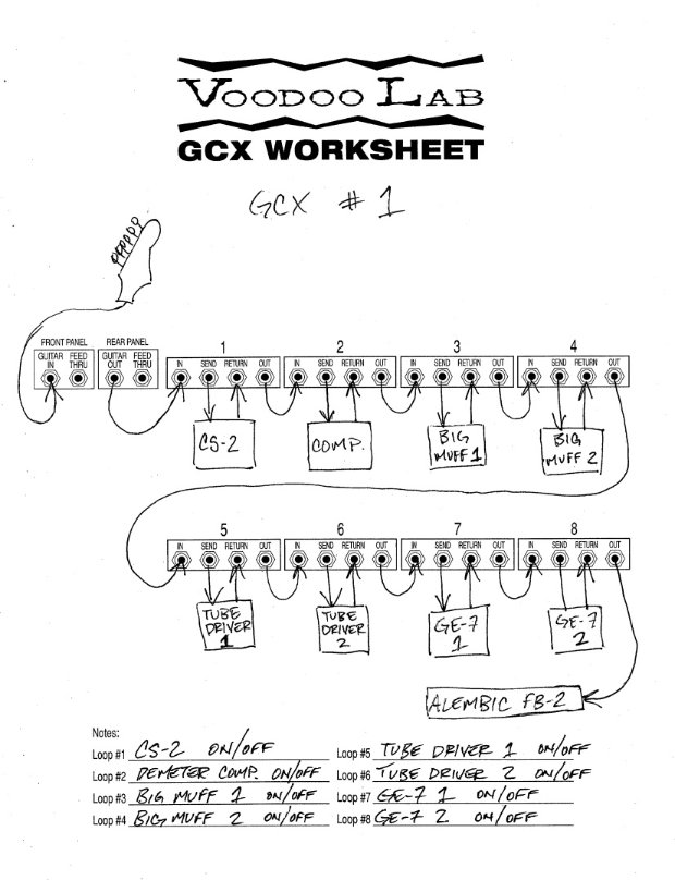

Sorry for the delay here. I admit i fell into a bit of a rabbit hole reading up on the Pulse Rig.
Here are diagrams for both GCXs running everything in the order as you've listed them. GCX #1 is pretty straight forward with eight pedals wired in series routed to the front of the FB-2 preamp. I wasn't quite sure about the GE-7s since the rig you are after had them all over the place as well as that they were all modded. I think here you will likely be switching between one or the other or none rather than both on at once. ...but please experiment and let your ears decide what sounds right!
GCX #2 has the effects after the FB-2 preamp with the Stereo split starting at the CE-2. You will want to use a Y-Cable (all three ends MONO) from the Out of Loop 1 to the In of both Loops 2 and 6. This will still drive both inputs of the Nova Delay or both power amp sections when the CE-2 is bypassed. Loops 2 & 6 and Loops 3 & 7 should be switched together to switch the stereo effects.

Wow, I must be slipping!
The only change would be to use the Y-Cable from the Out of Loop 2 on GCX #2 and connect it to the In of Loops 3 and 7. The Out of Loop 1 to the In of Loop 2 will be a standard Mono cable.

Re: Can Any Kind Soul Make me a Diagram
Instead of adding a second CE-2, you might want to consider replacing your existing CE-2 with a stereo unit such as the CE-5 or the CE-2W, etc. That way you're only swapping out the pedal and the wiring won't change.
As it stands, it looks like none of your patch cables need to be stereo. Just make sure the Y-cable you use is, as John wrote, a true Y-cable (3 TS Mono plugs) and not an Insert Cable (1 TRS Stereo plug that breaks out to a pair of TS Mono plugs).
Yea, this setup uses only mono cables throughout.
About the two choruses... sure you could use two but it isn't exactly going to make it stereo. A single chorus in front of the Y split will still provide a chorused sound out both amps in case that was not clear. In fact, this setup as drawn will have all sound coming from both amps at all times in a "dual mono" configuration, its just the Nova Delay that will be true stereo in that it could send delay repeats that alternate left and right for a ping-pong delay.
However, potentially more interesting is that running two mono chorus units with one on each side may produce an unexpected effect in the room since they are not working together to pan the signal back and forth evenly. I would assume that getting the speed set the same on both sides might be a little difficult, but then I'd probably try it out just to purposely set them to different speeds.
Let us know what you decide!
