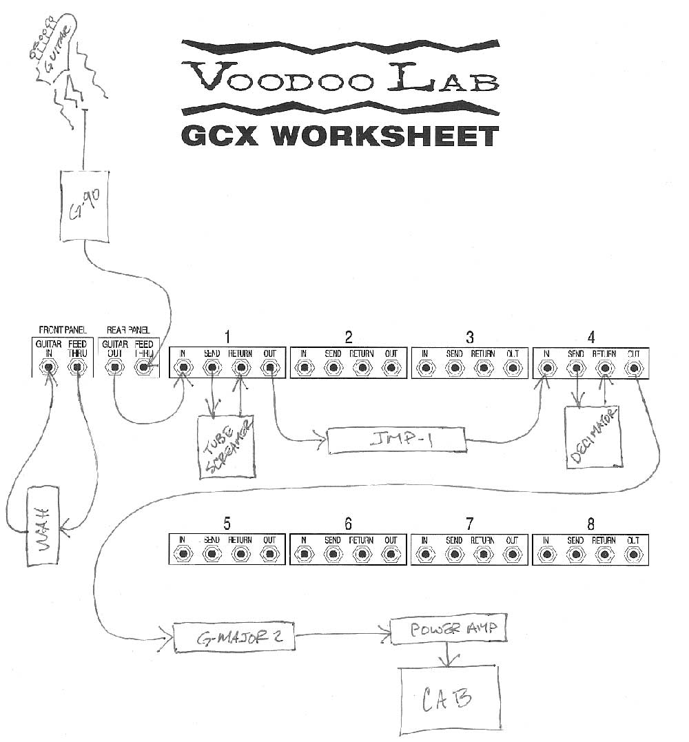

I don't know about the "best" but if I were handed this gear and needed to rock out I'd start off like this...
This would let you do everything you are asking for with room to add more pedals if you ever needed to.
With the Ground Control Pro set up in 4 Presets per Bank mode the bottom four buttons will send the JMP-1 and the G-Major 2 to whatever numbered sound you like as well as recall any GCX Loop combination you want. The upper two rows of buttons will be the Instant Access buttons that can be set to directly control individual GCX Loops or individual Effects Blocks within any G-Major 2 patch and even trigger the G-Major 2 bypass.
Try it out and let us know how it goes!

Hi John,
Thank you for the quick turn around on your input, and especially for the attachment. I will definitely try this out over the next couple of days and let you know.
