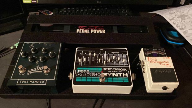

Hello, I’ve recently got into bass pedals and i bought myself some, but I don’t know how to choose the right inputs for the current draw, i have a pedal power 2 plus.
The pedals draw:
Tone hammer: 18-20V 0.3A
Electro harmonix: 9.6 Volts DC 200mA
Boss chromatic tunner: 9 Volts DC 200mA
Please help!

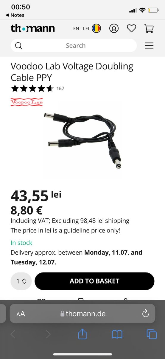

Note: i do have a voltage doubler for the tone hammer.

To power the Tone Hammer with Pedal Power 2 Plus, use a two 9VDC outputs (DIP switches set normal) and a Voltage Doubler Cable (standard polarity, 2.1mm), part# PPY
To power the Electro Harmonix with Pedal Power 2 Plus, use output 5 or 6, DIP switch in the 9V (normal) setting with one of the all black (standard polarity) cables supplied.
To power the Boss chromatic tuner with Pedal Power 2 Plus, use any 9VDC output with one of the all black (standard polarity) cables supplied.
To power the Cali 76 use output 5 or 6, DIP switch in the 9V (normal) setting with one of the all black (standard polarity) cables supplied.
Cheers!
