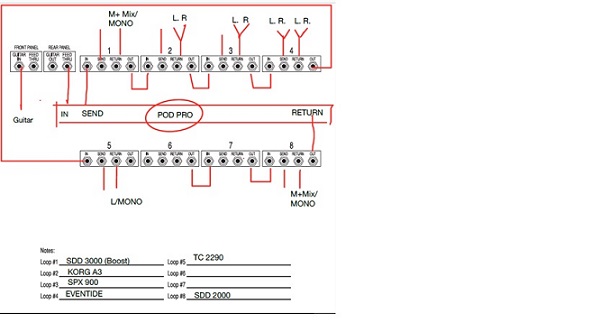

I post a worksheet .jpg about the way it is arranged.
As I said, it works when pressing instant access buttons of each device or a combination of them , but when MIDI joins in scene only POD PRO does.

Here are a few things I see...
1. Probably just a mistake on the drawing, but with no cable from Loop 5 Out to Loop 6 In, you will get no sound from any of the devices in the loops.
2. The stuff in Loops 2-4 should probably only be connected using the Mono jacks. If your GCX is all mono loops then there is no benefit to using the Stereo Outs of those devices.

Re: Ground Control Pro MIDI sound problems
1. Yes , a mistake on drawing . Loops 5 and 6 are connected
2. No led loops active on GCX when recall a preset
3. To hear the preset loop , justo to switch the button/s from 1 to 8 and led loops active as they are selected. No need to go to other menus from point 2.
