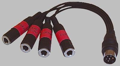

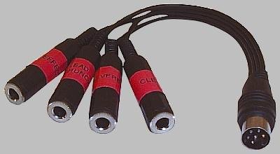

In order to use the GCX to control the Marshall's footswitchable functions you will need a custom cable. This cable will have the 6 pin DIN plug on one end that terminates out to multiple 1/4" ends. Here is a diagram someone would need in order to make this cable.

i have this cable i plug each cable at one send of GCX

Hi - Very helpful information. We just need to know where to get this adapter/connector you have pictured.

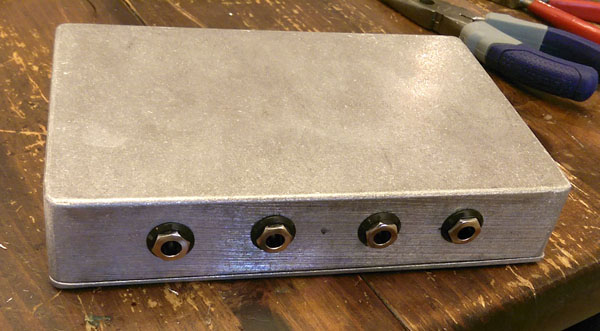

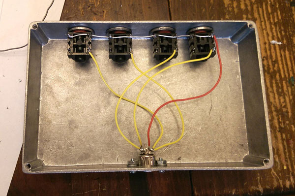

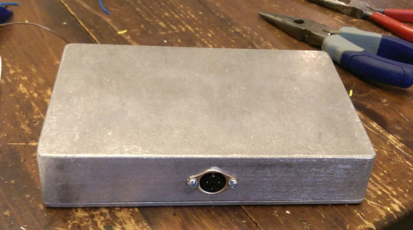

Appreciate the info on this topic. I just recently got a GCX + GCP and was looking for a way to control my Marshall TSL from them. I actually took what was suggested here and did something a little different. Given the issues everyone typically has with the TSL's footswitch cable going out, I had already modded the TSL's footswitch to have a female DIN connector (instead of the cable going directly into it) and a male-to-male MIDI cable to go from the head to the modded footswitch.
So, following the suggestions on this post, I built a breakout box with a female DIN connector on one side and 4 TS jacks on the other. I followed the wiring diagram, and bingo - it all worked just fine. I've attached some pics.
